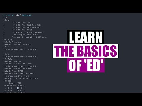

The ed and ex editors are great for showing others exactly what happened in the editor.

I recall watching these two videos on "How to use ed" a while back.. They were.... informative.
Links to Youtube videos below
and
